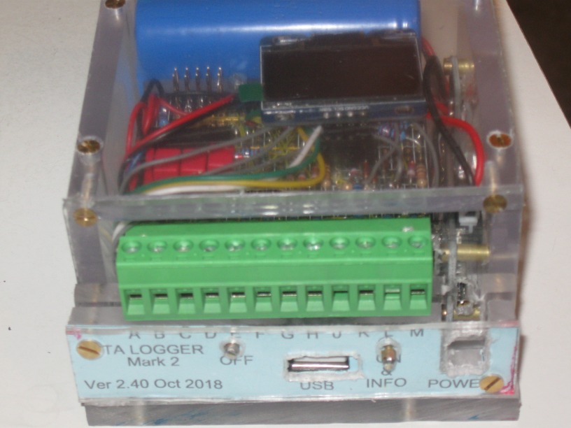

The front panel showing the push buttons and the USB socket, as well as the 12-way screw terminal block, which can easily be unplugged.

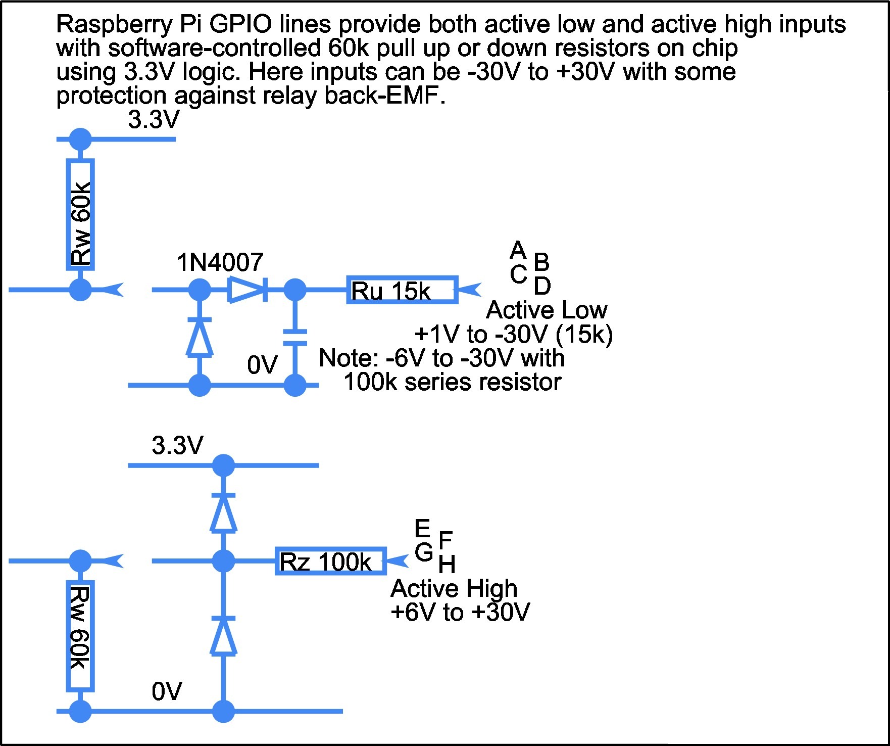

The GPIO inputs themselves on the Raspberry Pi used 3.3V logic and had software-controlled pull-up or pull-down resistors. The circuits being monitored used 12V, 24V or 50V and comprised a number of relay contacts in series with a relay coil. Some relays had spare contacts (making them easy to monitor) but some did not, particularly those monitoring track circuits.

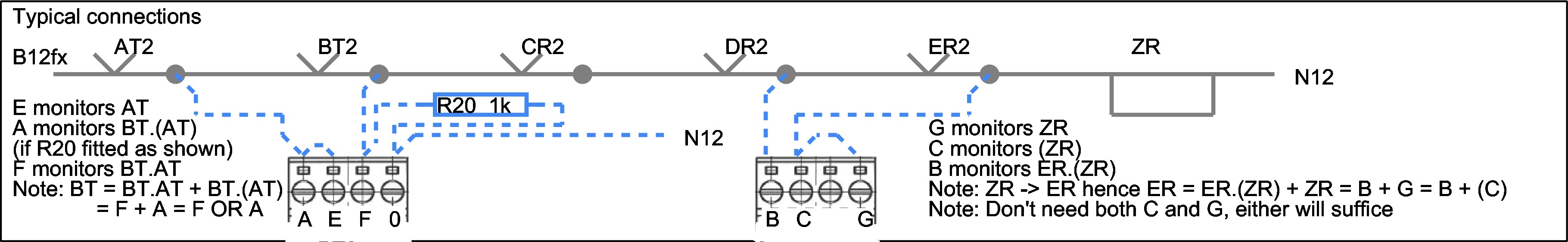

The ‘simple’ DC track circuit exploits the hysteresis of the relay so that it falls away at a known voltage and requires a higher voltage to pick up again when the train has gone. Monitoring the single contact provided is the only way which means breaking into signalling circuits without disturbing them.
The signalling circuit shown is a 24V circuit with the fused positive supply (B12fx) on the left and the negative return (N12) on the right. Inputs A to D are ‘active low’ and connected to GPIO pins GP5-GP8 which have, by default, pull-up resistors on chip. Inputs E to H are ‘active high’ and are connected to GPIO pins 17-19 and 23 with pull-down resistors.
That also means being tolerant of relay back EMFs as the relay coil circuit is broken. How resilient the unit will be in service is still unproven.
My first stab at protecting the GPIO 3.3V logic from the 24V signalling supplies and the hundreds of volts that might appear as relay coil circuits are broken. Each input is inactive when open circuit and can be activated in the voltage ranges noted. This gives a choice of +1 to -30V (which includes 0V); -6 to -30V (with a series resistor and excludes 0V) or +6 to +30V. Voltages in the range specified will make the input ‘active’.

Construction

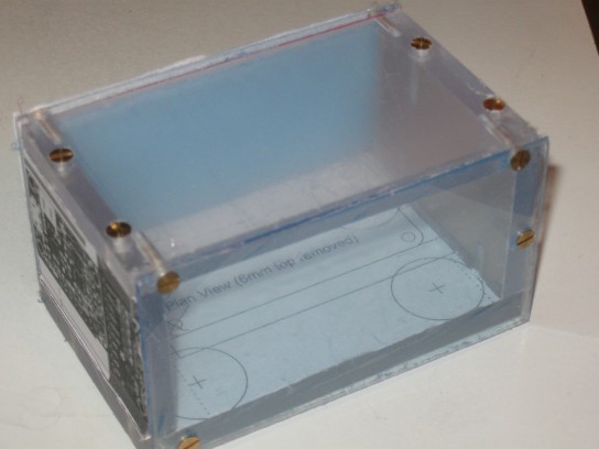

The case itself is made from polycarbonate sheet, cut to several different widths by the supplier that I cut to length with a hacksaw.
The case with printed labels stuck onto the protective film after cutting the ploycarbonate sheets to size.

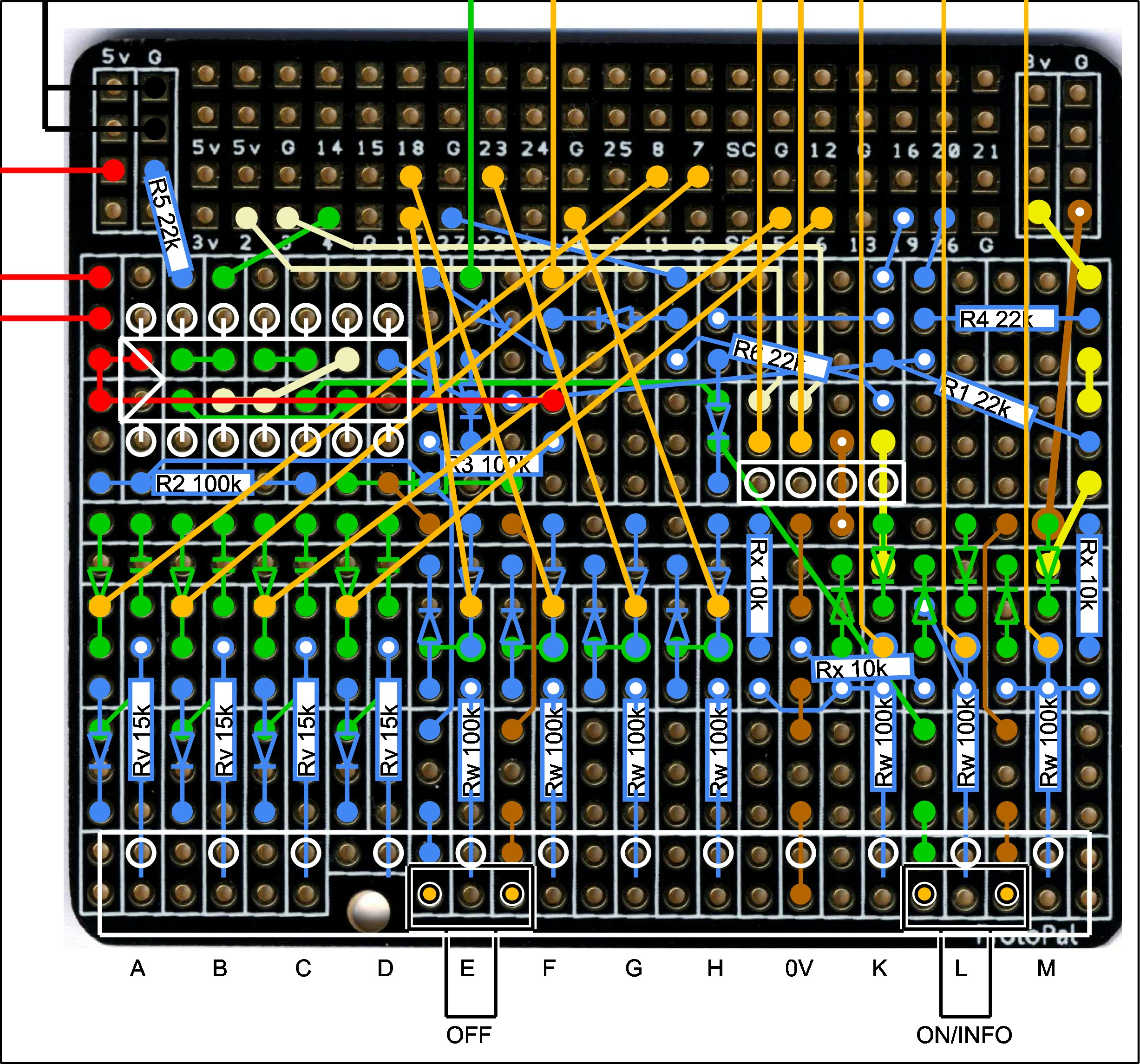

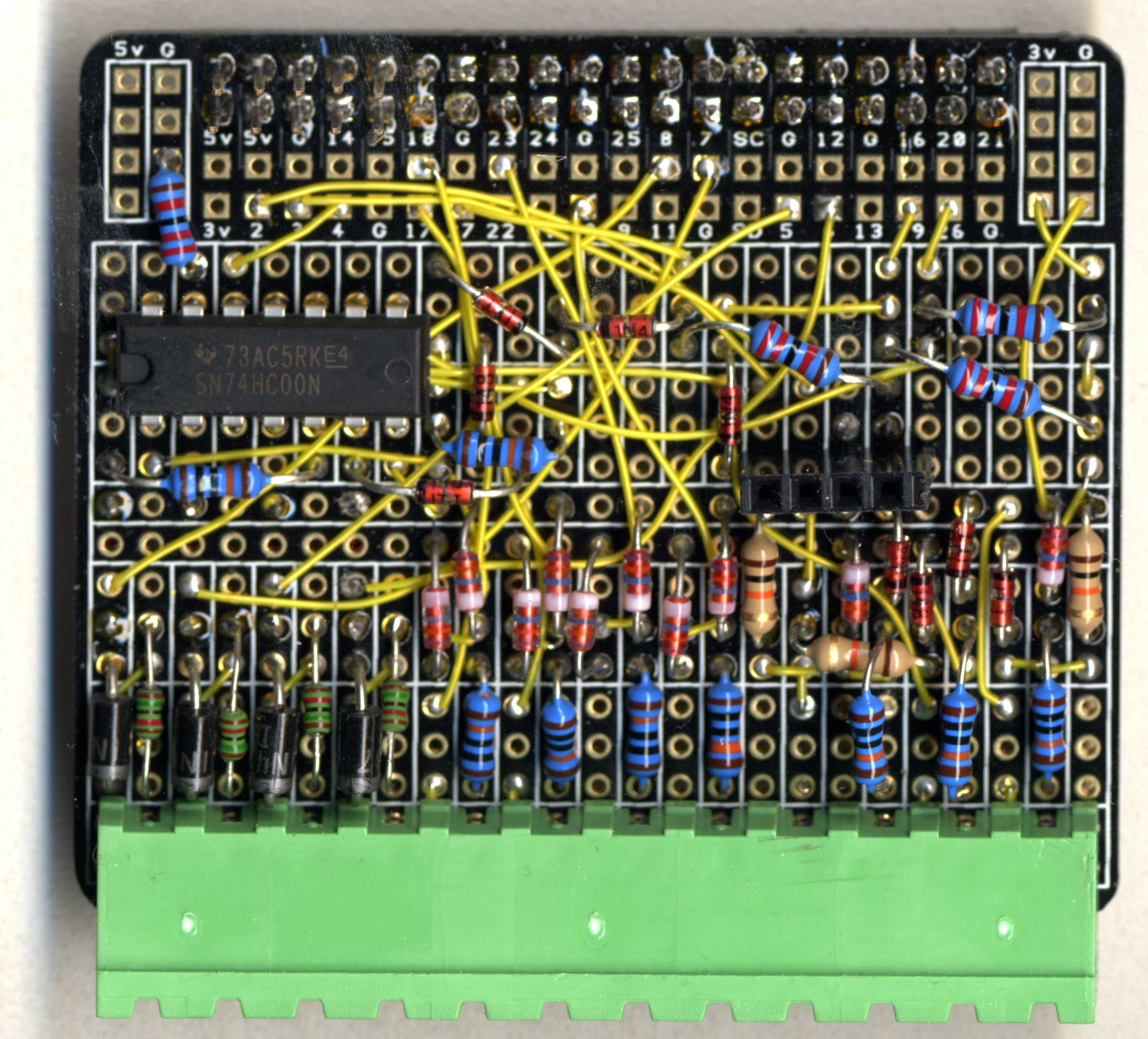

Most of the breakout circuit board is taken up with the various components needed to protect the GPIO inputs from harmful external voltages but otherwise it is a very similar layout to that used for the GPS unit. Circuitry to control power switching is identical.
Internal wiring. Signal diodes, 1N914, resistors and capacitors should protect the 3.3V level logic from +24V and relay coil back EMFs. Inputs will sink no more than 200µA to avoid disturbing the signalling circuits being monitored.
A side view shows the plug-in screw terminal block which can be connected to the circuits to be monitored using up to 2.5mm2 cable.
Eight inputs plus three voltage-measuring inputs (approx. 0 to 30V with a resolution of 33mV). The terminal block can be unplugged.
All I have to do now is to check for any dry soldered joints!

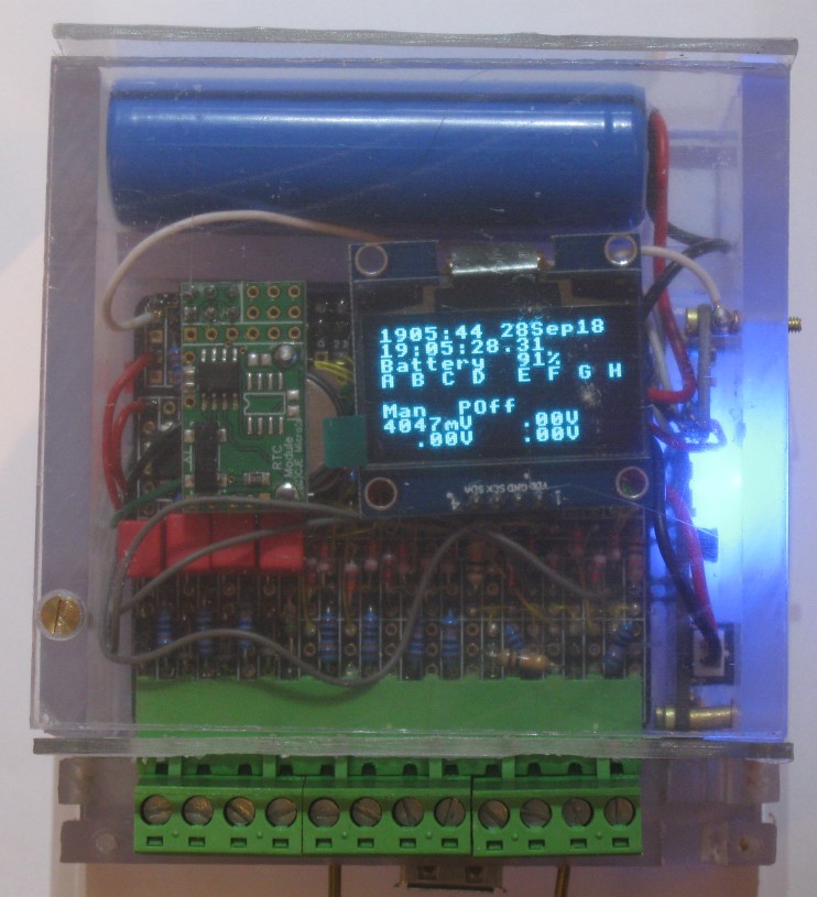

The OLED display shows the time of day and the status of the eight inputs and the three voltages (plus the supply voltage, which is the battery voltage unless it is being charged by a healthy external supply.
The OLED display shows the time (in GMT) updating once per second on the first line and shows the exact time of the last log entry on the second line with the status of each input as logged. On the line below the letters A to H will appear an ‘X’ if that item is active. The line showing ‘Man Poff’ indicated that the unit was switched on manually with no external power and that was the last change of state (an ‘A’ would mean A went active and ‘a’ inactive). The four voltages are those measured at that time. 3.807V implies 54% battery life. The other voltage inputs are not connected.

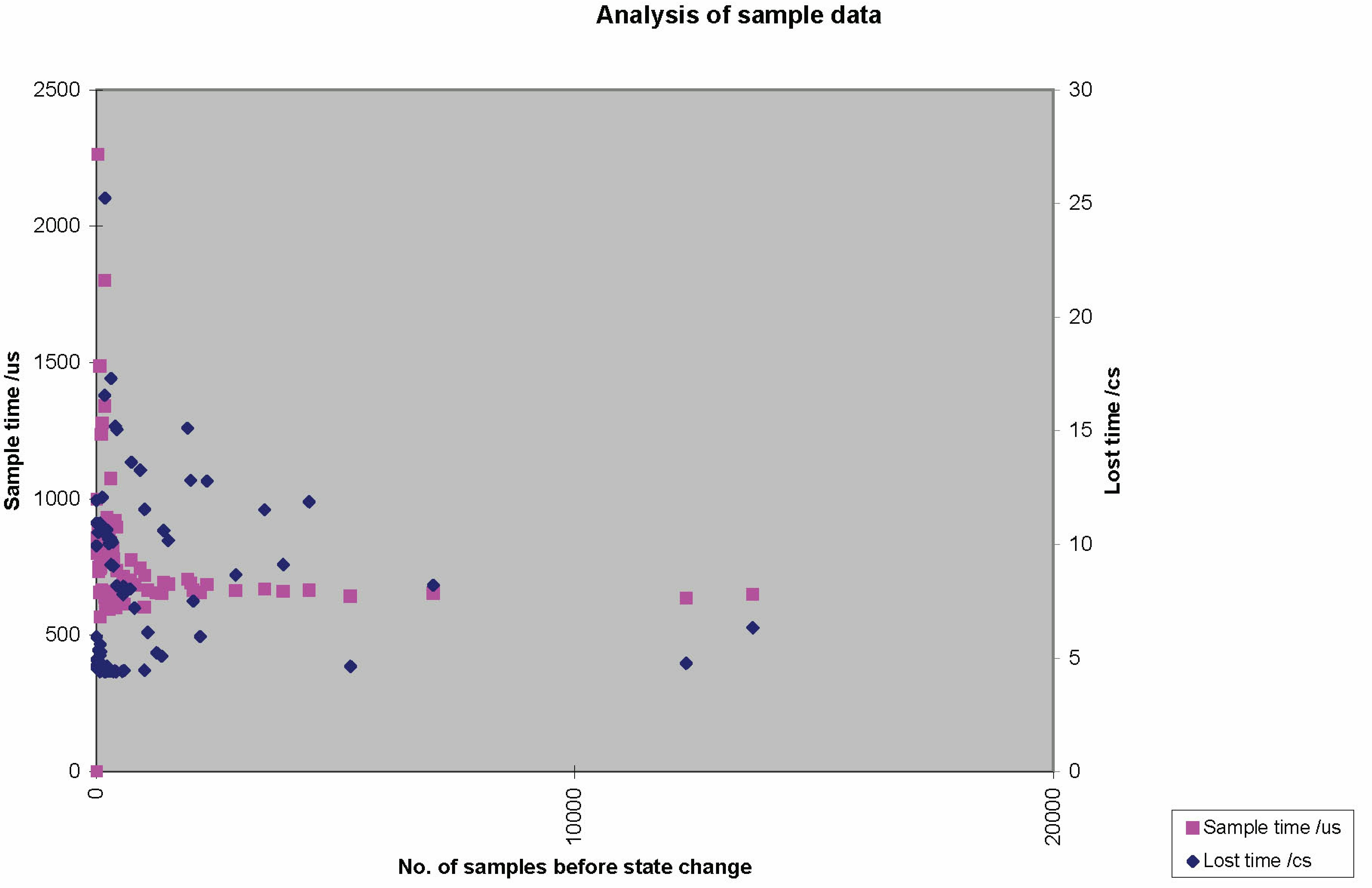

An analysis of the sampling shows that the sample interval is about 650µs (pink dots) while ‘lost time’ (for example to update the OLED display - 8cs - or to measure voltages - 5cs) is generally less than 12cs.

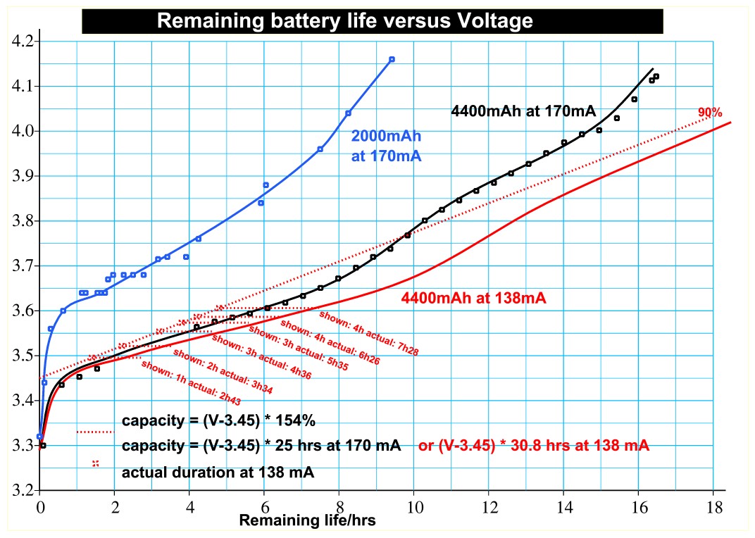

The battery should last about 18 hours (at 175mA) and the voltage reading can be used to indicate the battery life remaining, as above.

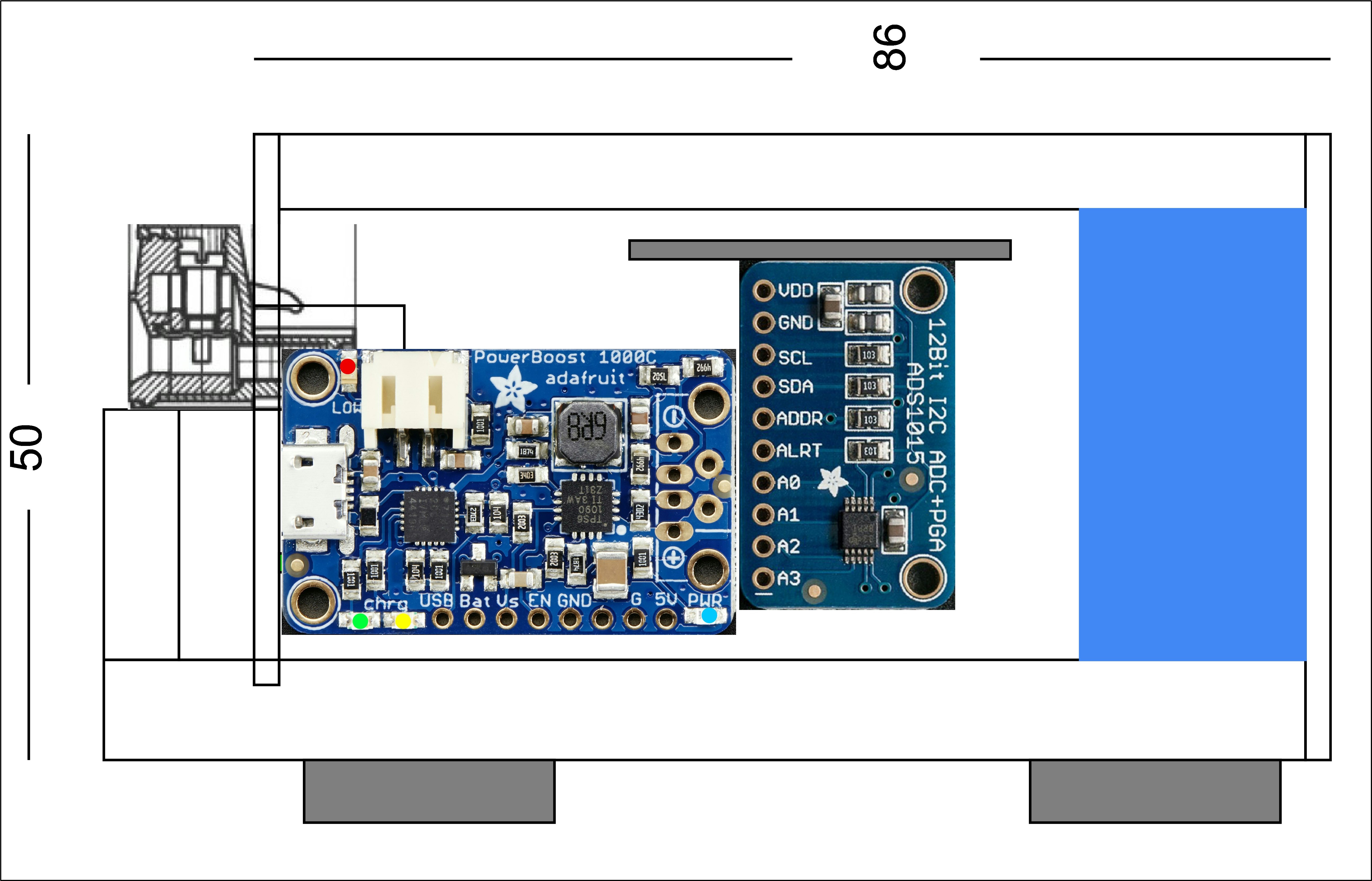

Powerboost board
The ‘power booster’ board allows an internal 3.3V Lithium-Polymer battery to produce a 5.2V output and will use an external 5V power source to take over this rôle and charge the internal battery until fully charged. Switching on and off is controlled by an ‘ENABLE’ input.
A blue LED lights if power is being supplied to the computer. With the booster board output disabled, only a minimal current is drawn from the internal battery. A red LED lights if the internal battery becomes discharged below 3.2V (a diode is fitted to disable the output automatically). Fully discharging the internal battery is likely to damage it.
While the internal battery is being charged a yellow LED lights, turning green when it is fully charged. A small current drain to light the green LED to show a full charge seems enough to keep some power banks happy even whilst the unit is otherwise powered down.
This means the external source can be connected and disconnected without affecting the operation of the device except to extend battery life.
Analogue to digitial conversion
The ADC board is the 12 bit ADS 1015, by Adafruit, and it takes about 5cs to check all four voltages. I did try a 16 bit version but it took quite a bit longer to do the same sampling. I had also included the voltage sampling in the same block of code as that examining the eight GPIO pins for any state change. This meant that the unit was sampling at about 10Hz.
I realised that state changes of the GPIO pins needed to be monitored more frequently and voltages only really needed to be recorded at any state change. This improved the data sampling rate to 20Hz.
The next inspiration was that the OLED display was being updated each time there was a state change.
The OLED module keeps a sprite in memory which is updated line by line as text is written to the display drivers. Every so often, the display is updated via the IIC bus, which takes about 12cs.
There seemed no point in updating the OLED display more quickly than the eye could see so I held back updates if the display had been updated in the last 2s. The sampling rate rose to 1500Hz.
The Organic LED Display
The OLED display shows the active/inactive status of the eight inputs under the headings A to H under which an ‘X’ appears if the circuit concerned is active, updating every 30 mins or whenever any of the inputs changes state. The three voltages being monitored are also displayed, updating at the same time. Time and date is also shown, in GMT.
This continuous display allows the set up of the unit to be checked easily and the last recorded state change is displayed along with the precise time (to the nearest hundredth of a second) that it occurred.

Battery endurance
The internal rechargeable battery is monitored for state of charge each time any of the eight inputs changes state: it will show either ‘xx%’ (while power is off) or ‘chgng’ (whilst being charged). Below 3.2V it is discharged and the power boost board will force power off. The battery should last for 500 charge/discharge cycles.
